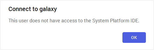

Hi. I have a 2014 System Platform Galaxy that I am migrating to 2023 R2. I have done the migration without any issues but now when I try to open the Galaxy I get an error message saying that "This user does not have access to the System Platform IDE". The galaxy is setup with Galaxy security so I would expect the IDE to ask me for a username and password but this is not the case. I migrated the exact same galaxy to a test VM I have with SP 2023 and here it works fine, it asks me for my username and password and then the galaxy opens. Is there any way to force a galaxy to request a username and password from the SQL side as I am not able to access the galaxy at all at the moment in the 2023 R2 version. My other option is to disable security completely in the 2023 version and create a new backup and then import that into 2023 R2 but my issue is the galaxy is quite large and takes about 3 hours to backup and another 4 hours to restore. If I can only edit the correct table in the SQL db to force my galaxy to ask or the login details I will be able to log in which would be great. I have made sure my current windows user is added to aaAdministrators and aaConfigTools user groups just incase but it still does not work. Thank you for any comments.

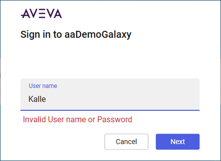

    Is it the same for all users? and can you log in using the built in account "Administrator"
    An invalid user should show a different prompt.

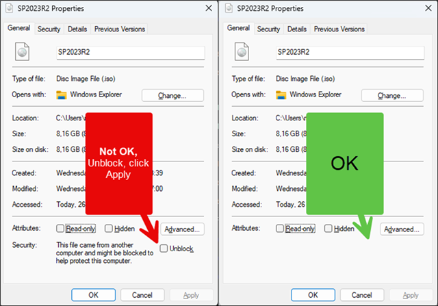

    Also, when installing the 2023 R2 Version, did you unblock the installation media prior to the installation, I know it might sound far-fetched, but as long as AVEVA's official statement on this topic (through tech support) is that "wierd sh** can happen", I would still have this on the list to check.

  • Hi Richard.
    That first screenshot you sent is the prompt I get yes. My big issue is I am expecting the IDE to ask for my login details, but it does not ask for it, it says connecting to galaxy and then gives that prompt.

    I did check if the installer was unlocked after I did the install but luckily it was unlocked.
