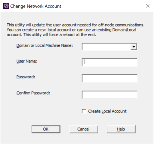

    Make sure that both GR and AOS nodes are configured with the identical account (either domain or local account) for System Platform Network Account on installation. You can launch the following utility from Windows Start Menu\AVEVA on both nodes to confirm if they are configured to use the same account. Changing the network account will require the restart of machines.

  •  Hello Jacky,
    Thanks for reply. Network account is same for both nodes and is domain user, which was copied from administrator.

  • Hi  Evheniy,
    The mismatched network account is a primary contribution to this issue. Another option is to temporarily modify Local Group Policy - Enable "Elevate without prompting" on the deployment target machine.

    Do I have include Network Account in BUILT-IN\Administrators + aaAdminisrtators (or only to one of this group) or Change Network Account application will do everything what is needed for this domain's account?
    If I will choose to use local Network Account on every node - do I have include this account in local machine Administrators group or domain's BUILT-IN\Administrators + aaAdminisrtators (or only to one of this group). Or Change Network Account application will do everything what is needed for this local account?

    As for the network account, it should be included in the local Windows User groups, aaAdministrator and ASBSolution on each node of System Platform. The same user (with the same password) must be used across the entire system regardless a domain or local user account.
