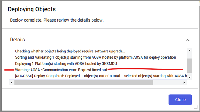

    Yesterday I rebuilt VMs. The only difference from previous installation is that there are no warnings about SMS. But on-scan still there - I can deploy and undeploy WinPlatform but not start on-scan.
    While deploying, everything is going well up to marked moment:

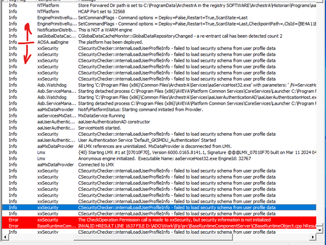

    After info and later errors from xxSecurity appeared in log. Errors appeared immediately with warning "Communication error. Request timed out" in IDE:
    Do you know what user is mentioned whose security schema from profile data has failed to load in above log records? Probably it is a source of problem?
    Info xxSecurity CSecurityChecker::internalLoadUserProfileInfo - failed to load security schema from user profile data
    with following errors:
    Error xxSecurity The CheckOperation Permission call is made to xxSecurity, but security information is not initialized
    Error BaseRuntimeComponentServer INVALID HRESULT LINE 1637 FILE D:\ADO\Work\8\s\src\BaseRuntimeComponentServer\CBaseRuntimeObject.cpp hResult 80004005
