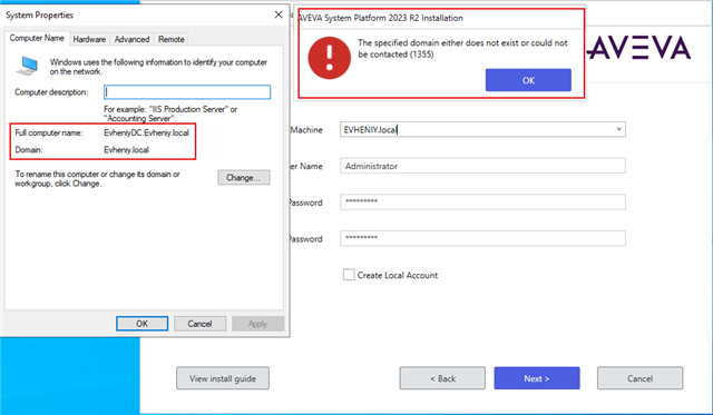

I have another question. When I tried install Intouch Access Anywhere on domain controller from SP2023 installation as product Intouch Access Anywhere Server and Runtime, installation asks about Network Account but didn't accept domain user which I'm using on other nodes with error that domain is not found. So I decided provide local user, install and later change Network Account. Installation has started but on step of registering aaLogger service failed because of insufficient rights. I started installation again and again but Network Account was never asked after first unsuccessful attempt.
How I can revert back and force installation asks Network Account? Doesn't it supported to provide domain name and domain user in Network Account dialog box being exactly on domain controller?

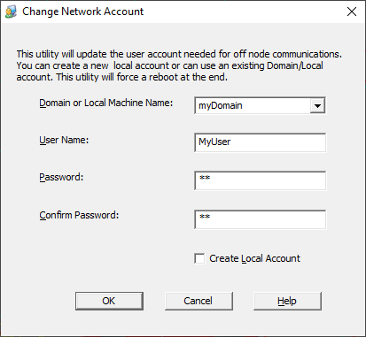

    Only way to change credentials in this case is to finalize the installation and change the Network account after the installation is completed using the Change network account.

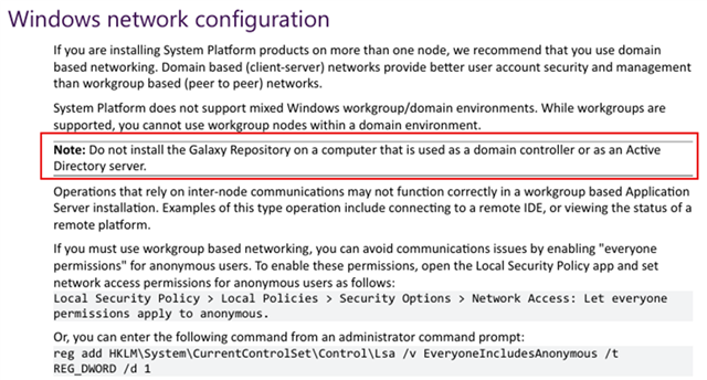

    Lastly, I recall that most Aveva products does not support being installed on the same node as a Domain Controller, but I'm not sure about InTouch Access Anywhere, this have to be checked.
  • My bad. Perhaps its only the GR Node that does not support being installer on a Domain Controller.

    Problem that I can’t finish installation because of aaLogger can’t be started. User, under which I started installation, is the domain administrator, under which I installed SP on other nodes connected to this domain. I found a few keys Wonderware, AVEVA, Archestra in Registry, deleted them but it doesn’t help return Network Account dialog back. So should be something else additionally where installation has remembered NA user. Good idea with anonymous logon in Secpol, I will check it. Maybe some other security settings might be helpful? Or uncheck aaLogger from installation options if it is possible, to finish installation. Or maybe there are a some option keys to run setup.exe?
    By the way, do you know if it s right that Change Network Account doesn’t accept Name of Domain if one start installation at Domain Controller?
    Yes, I know note about GR on domain controller but never tried. Definitely will do it just to check if it is really not possible Slight smile.

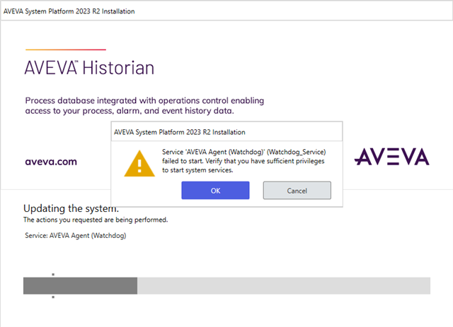

  • I can at least confirm that I am unable to use the domain account "Administrator" on the domain controller.
    And I could reproduce the issue of fail to start services upon installation, but in my case it was the AVEVA Agent, Watchdog Service.
    this with the usage of the Administrator domain admin account.
    Need to do some more testing to find a workaround, but at least you know it is reproducible and nothing personal ;)

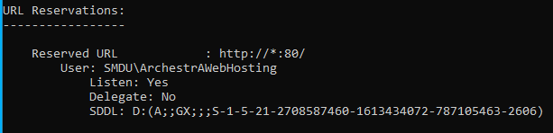

    After I Configure with connection to existing SMS. Certificate from existing SMS was downloaded and installed but configuration failed because ports needed (80 and 443) are occupied by someone else.
    Netsh tells that this ports are reserved by ArchestraWebHosting.

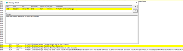

    If I redefine ports via Advanced, configuration also failed but with error
    Just to be sure that problem not in Network Account, I changed it on SMS and domain controller to the user SPAdminloc - it doesn't help, same result.
    So, challenge still go on but I'm out ideas.
