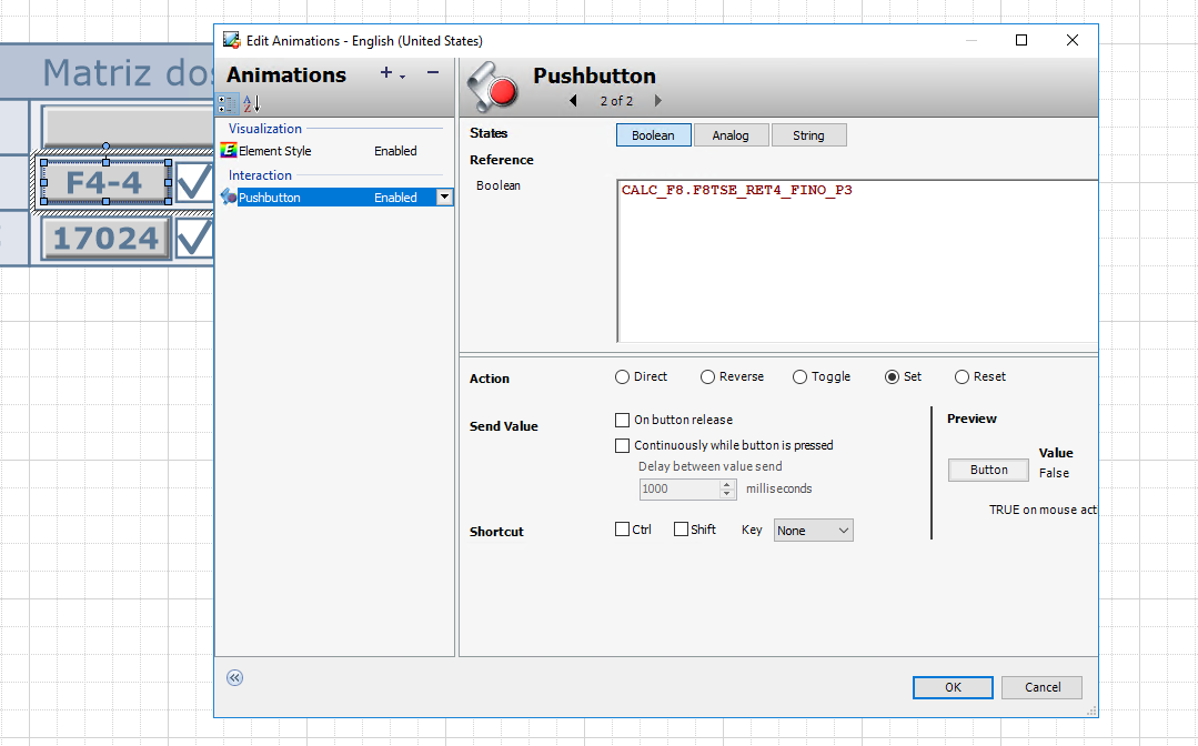

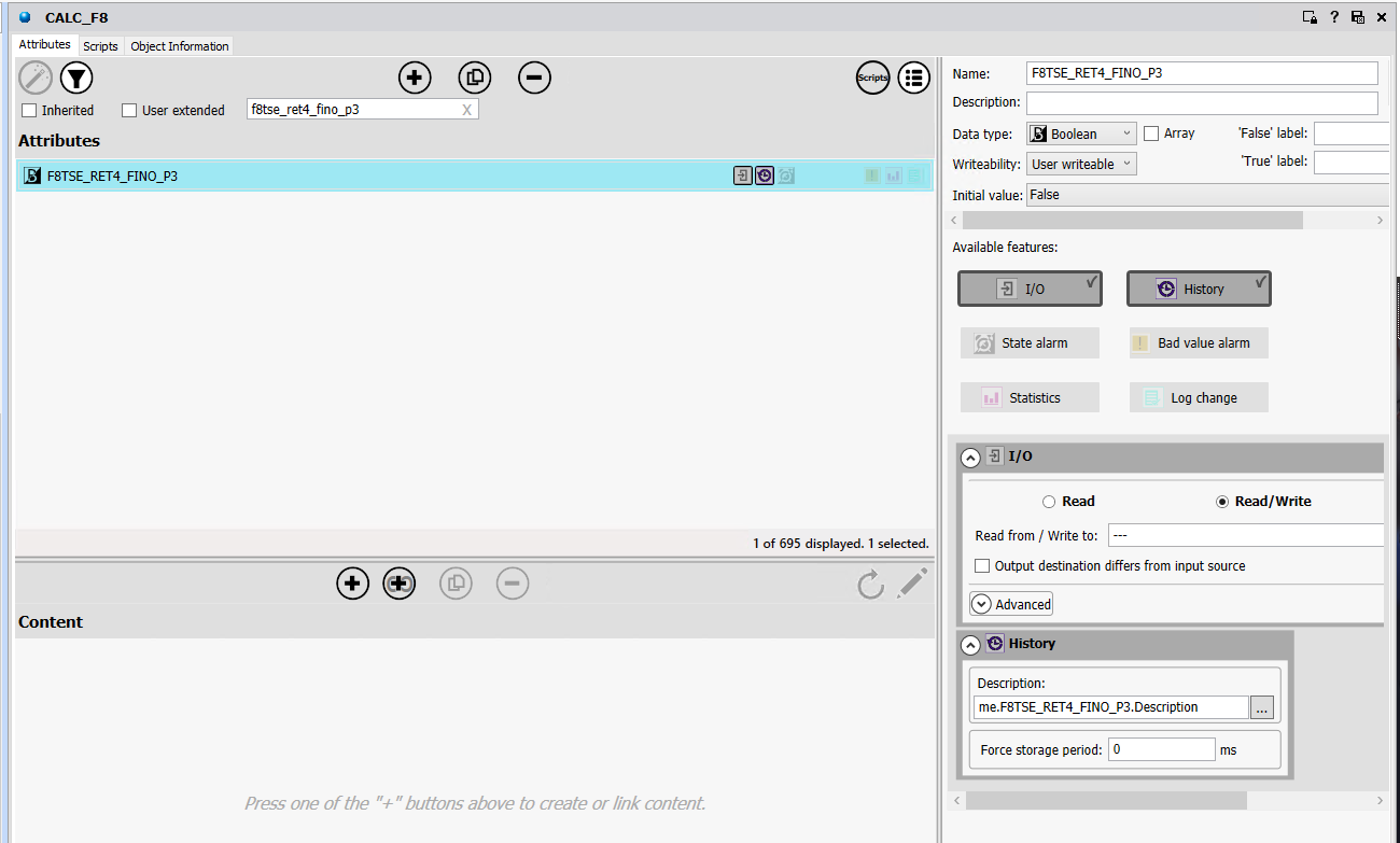

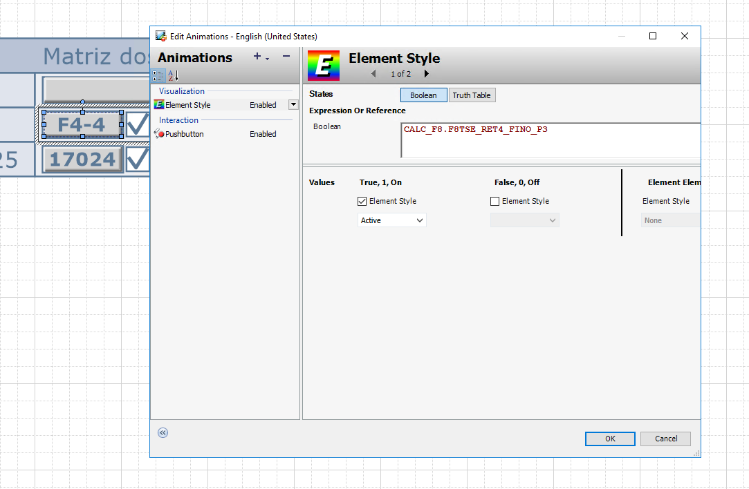

I am having a problem with OMI Viewapp 2020. I'm using a pushbutton, but it is not working right. When I toggle the button, it doesn't change in the PLC, but if I change it in the PLC, it changes in the OMI Runtime. Maybe it is a bug because sometimes it works and sometimes it doesn't. All the TAGs are right, including the instances. I'm uploading some screenshots to explain the problems.

  • I am guessing you set the InputSource to a specific tag on the PLC, right? We may have to walk this through and try to figure out why this is happening:

    2. If security is not the issue, you can Open Object Viewer and bypass OMI.
      1. Rightclick the object (CALC_F8)
      2. Select Open in Object Viewer
      3. Once it is open, find your attribute (F8TSE_RET4_FINO_P3) on the right (you may want to sort by attribute name).
      4. Click and Drag it into the Watch window
      5. Now double-click it in the watch windo and try to change the value.
      6. If it does not work, there should be an error message telling you why.

  • Here is a troubleshooting tip that may help. In the Quality and Status settings enable the outline for each status and choose a unique color for each status, For example if you select purple for security then any time the attempted action is rejected due to security permission a purple outline will appear around your button. The internal messaging system carries the write status and these indicators are a simple way to add them everywhere without having to touch your symbols. You can leave them on or turn them off after you are done troubleshooting if you prefer.
