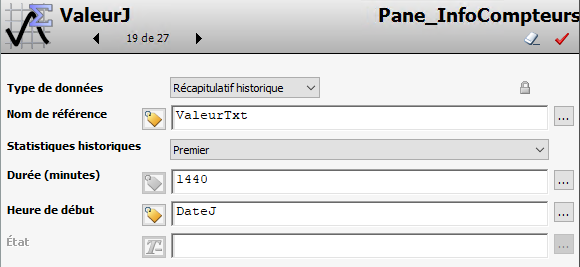

We are encountering an issue with the custom properties "History Summary."
Since our migration (from 2020 R2 P01 to 2023 R2 P01), our symbols retrieving "History Summary" values are no longer functioning.
For example, with the configuration below, the "ValeurJ" property returns the value "NaN":
Reference name: ValeurTxt (concatenation to form the tag), same result when directly pointing to a variable
Duration: 1440 (24h)

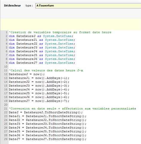

Start time: DateJ (string) retrieved by script OnShow (below) in the format (30/08/2024)
Has the configuration of this custom property changed since the 2023 version?
