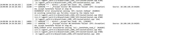

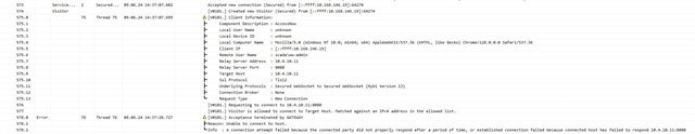

does anybody know weather it is possible to run ITAAGateway version 20 with ITAAS 23.?
I have one system up and running, with OMI2020 web access through ITAA Gateway v.20  and Server v.20 (everything installed together from SP2020 installation)
I am now running another OMI v.23 from another galaxy on the same network.  I have installed ITAA Server 23 on that machine.
I want to be able to use the same ITAA gateway for accessing both of the  ITAA Servers.
I get the ITAA login window when navigating to the server,  but the login times out.
Is there anyone that can verify that the gateway version and server version need to be the same for the access anywhere software to work?
Screeshots from log on ITAA20 gateway side and log on  ITAA23 server side
