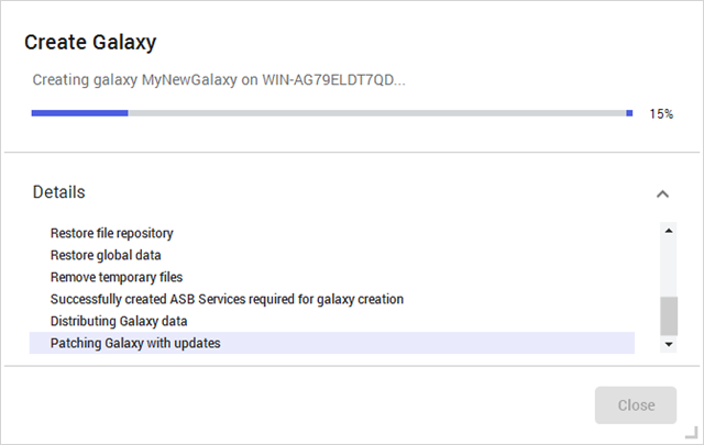

Hi everybody, does someone has install AVEVA system Platform 2023 R2 P01 on AVEVA system Platform 2023 ? Because for me, I get 2 problems, first it's taken 2 minutes more to create a blank galaxy because it overwritefiles. Why haven't create galaxy with template with files already patched ? And the second problem,, on OCMC during the galaxy construction, there is red alerts : Access denied with WWCdi and WWPackageServer. It seems to be the same problem with AVEVA Server 20212 R2 and path 01 and SQL Server 2008. So If you have some solutions, I will ear for it. Or shall we wait for another patch in order to get a solution for this 2 problems.

    On a system where System Platform 2023 R2 P01, the process of creating a new blank galaxy will patch the new created galaxy as part of the creation process. This unfortunately lead to long waiting time for creating the final galaxy, up to 5 -10 minutes even on a good performing server.
    I can agree that the Patch should deliver an updated version of the Default_Empty.cab that is used as a template, but I guess that would impact the final size of the Patch 01 and it was not part of the patch. It has been similar scenarios in previous versions.
    Hopefully this does not case to much issues for you since creating galaxies might not be such a frequent action (it is a pain when performing Application Server trainings or if you have the role as techgeek though :) )

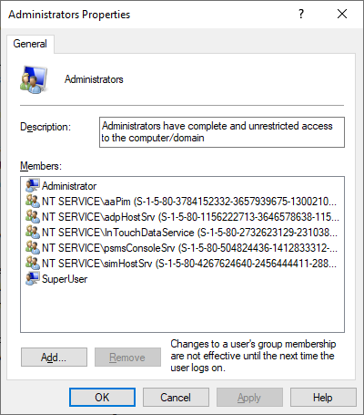

    Focusing on version 2023, are your local admin group still have the aaPim user (could be removed by policy).
