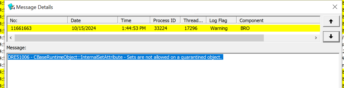

Warning in Log viewer related to the BRO component
I made some minor changes to a Area object which resulted in a error in the log  - "DRE51006 - CBaseRuntimeObject::InternalSetAttribute - Sets are not allowed on a quarantined object." It relates to a component called BRO. What does the BRO component related to? and what does it mean that a object becomes quarantined?
note: "DRE51006" is the name of the area object.
  • Most likely a script on this area object DRE51006 is running into an exception which is resulting the object quarantine. Review the scripts on this are object to identify the problematic script and fix the code causing exception.

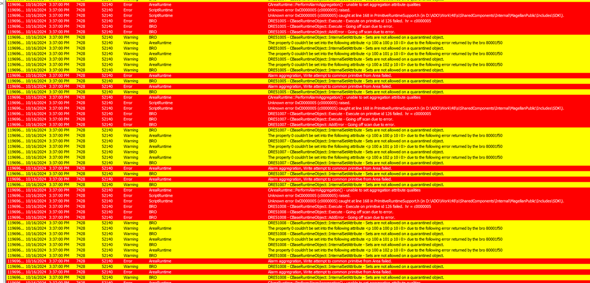

    I did some more work trying to fix it. Here is a screenshot with more comprehensive results when deploying more of the  area instances with the propagated changes. This shows all warning and errors related to the deployment
    I gave up debugging it and restored a backup.  I guess sometimes it is not possible to identify the root cause. But thank you for your help and taking time to answer!
