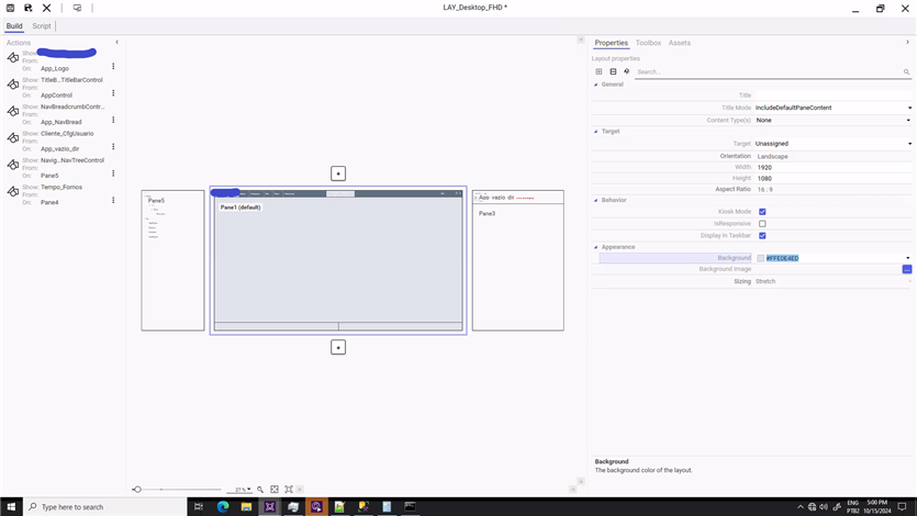

I would like to access the properties of pane1
, specifically to change the background via a script. I know that in some cases, the myContent
object can be used, but that's not applicable here. Is there a way to access the Pane
directly?
directly?

Thank you for the response, Edward. I would like to use the Galaxy Style Library to change the background, but from what I've seen, I would need to add a background rectangle to each process screen, which I would prefer to avoid.
