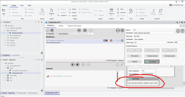

  • Hi Damon, I’m familiar with System Platform and Pi , so I’ll give my idea based on this and same could be replicated to Enterprise SCADA. You can write the alarm in System Platform to trigger a REST API put request into Aveva Pi using Pi System Access . This will be event driven. Within System Platform embed the alarm to provide setpoint in the alarm comment. Using Pi Asset framework you could pick this element . All the above can be done using templates and then easily do instances from them
