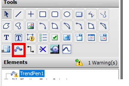

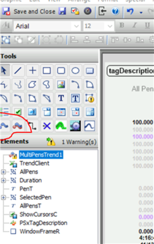

Is it possible to use a multi-trend pen in ASP2020R2? I noticed that this feature is available in ASP2023R2. How can I display multiple trends using the trend pen in ASP2020R2?
ASP2023R2
ASP2020R2

    The multi-trend pen was introduced in newer versions and it is not possible to "import" a newer component to an older version.

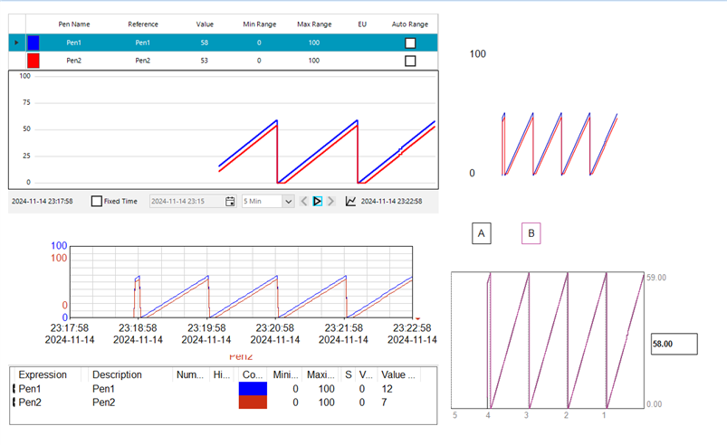

    But you still have some available tools to achieve a trend with multiple pens.

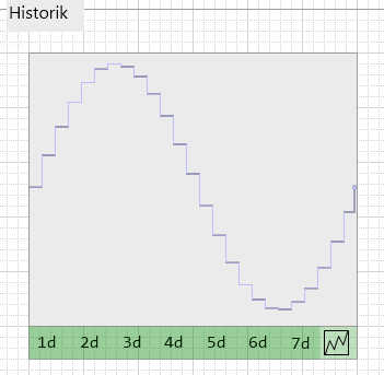

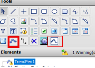

    Have you explored the Trend Client, or the symbol SA_Trend_MultiPen? And if you are using AVEVA Historian as your historical source there are even more options.
    You can also use the single pen to stack data on top of each other.
    But the multi-trend comes with some ready made tools that you can use in runtime so perhaps it requires some work to get similar features in place. (Setting duration etc can be done by scripting) It all comes down to your requirement.
