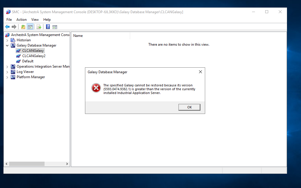

Hola amigos, por favor pregunten, ¿alguien tendrá claro qué versión necesito para restaurar esta galaxia?

  • For 17.3 SP1 P01 is 5593.0474.8972.1. Your version is 17.3.SP1 P01 with hotfix. The hotfix you will need to create ticket to ask support.
  • As Kian stated you need to make sure you are on same version, it is also possible to open a galaxy in a newer version of system platform, but keep in mind that its not possible to modify and move back to an older version. so it depends on your intentions.
    For future references, there is some good documentation on how to identify version on a backup cab file.

    But in your particular case the exact version number is not listed, that means that your galaxy has been patched by some less official update (aka. a Hotfix).
    I will also paste the version list in this post, "for the googles" ;)
    NOTE: If you have applied a hotfix for Application Server, the hotfix might update the CDIVersion to a version not listed below. The actual installed CDI version can be checked by checking the File Version of  <installation drive>:\Program Files (x86)\Common Files\ArchestrA\Framework\Bin\WWCdi.dll.
