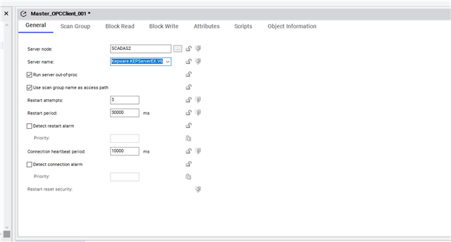

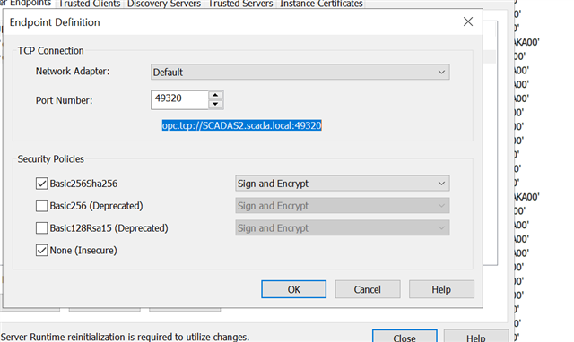

  •   hi again, I configured one instance of opcclient to connect to kepware, it works fine, but how do I know if i am using opc da or ua, I assumed I should put the path from the OPC UA server (on the screenshot below .) somewhere in the instance settings.
    This works if I put this data in the opcclient instance , (screenshot below:)
    Is this configured as OPC UA connection?

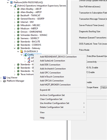

  • Hi   you need to first add OPC UA connection in Operations Management console
    Please see the link below for detailed instructions
    https://docs.aveva.com/bundle/sp-appserver/page/689813.html

  • Hi Jakob,
    The Application Server OPC Client object does not support OPC UA (yet) so I would say that in that case you are using OPC DA connecting to your Kepware server.

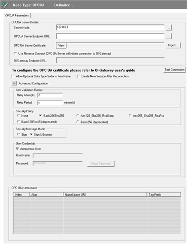

    To have System Platform connect to a OPC UA Server you need to involve the OI Gateway using a OPC UA Connection node.
    And then use a communication object (preferably the Suitelink object or the new PCS connection protocol (New in 2023).
    OPC UA requires some additional configuration that you will not find in the OPC Object
    And enables new features other than DA (Data Access) such as Methods.

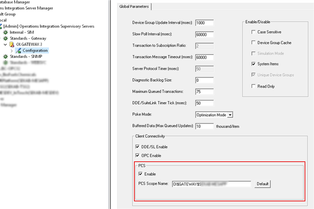

    As you and Rainer mention it is advised to move away from OPC DA over network due to the Microsoft DCOM Hardening initiative witch in some cases makes it impossible to communicate with a 3rd party OPC DA Server over network. A workaround could be to install OI Gateway locally on your OPC DA server node and use Suitelink/PCS to manage the node to node communication.
    (PCS removes the need of a Application Server communication object (OPC/Suitelink_DDE), but requires some additional configuration if you have not implemented it before).

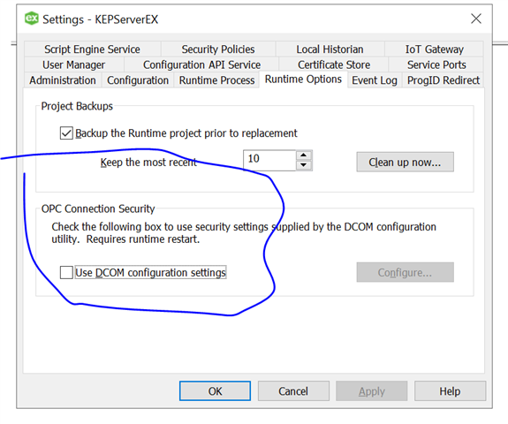

    The newest hope is deactivating this option in the kepware settings that I also just noticed, screenshot

    I disabled the The Dcom config settings on the screenshot from last post, I have had my test connections running for at least 3 hours now which is a record.  So i am hoping that tomorrow when i return to work it is still running.
    will keep you posted, and thank you!
