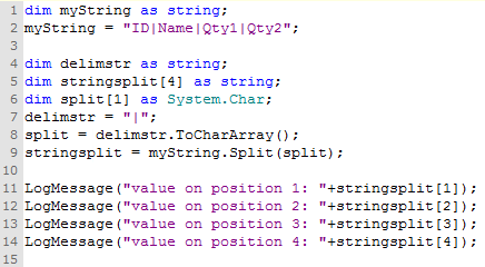

    Please try the following
    dim myString as string;
    myString = "ID|Name|Qty1|Qty2";
    dim delimstr as string;
    dim stringsplit[4] as string;
    dim split[1] as System.Char;
    delimstr = "|";
    split = delimstr.ToCharArray();
    stringsplit = myString.Split(split);
    LogMessage("value on position 1: "+stringsplit[1]);
    LogMessage("value on position 2: "+stringsplit[2]);
    LogMessage("value on position 3: "+stringsplit[3]);
    LogMessage("value on position 4: "+stringsplit[4]);
