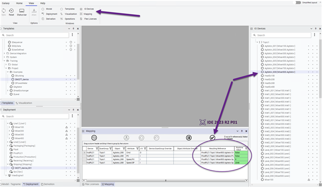

  • To verify resulting references, I use the IO Device and Mapping tools in the IDE.

    The departure of wwClient did leave a gap, and we are (finally) considering how to address that. We want to provide direct feedback on connection state as well as easy access to validation tools for IO references. Some of this may start to appear in releases during 2025.
    I commonly see people using an OPC Client as substitute for wwClient but that has its own challenges of course.
