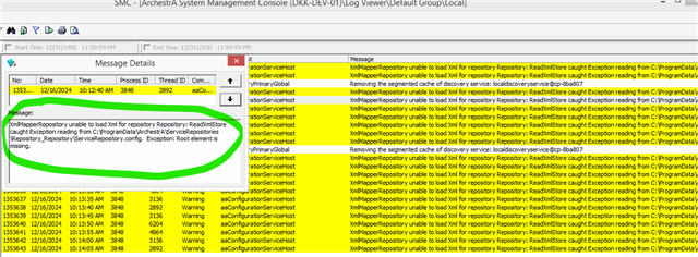

This is the error in question:
"XmlMapperRepository unable to load Xml for repository Repository: ReadXmlStore caught Exception reading from C:\ProgramData\ArchestrA\ServiceRepositories\Repository_Repository\ServiceRepository.config.  Exception: Root element is missing."

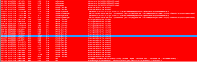

Here's all the other relevant errors I could find:
