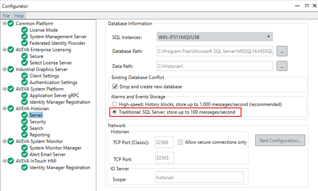

Hi,  I have a system which I intend to change  the alarms and events storage
It is now saving to a SQL database and I intend to change it to history blocks.  It has been running the last 5 years with the SQL option.  I am wondering if there anything to keep in mind that can go wrong or is it just a matter of changing the setting in the configurator and that's it?
regards
Jakob
  • Hi Jakob!

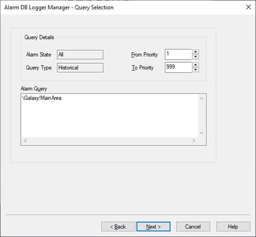

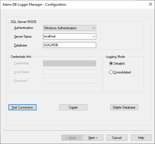

    When you select the Traditional option in configurator, it will create the (legacy) A2ALMDB SQL Database for the storage of Alarms, Historian will not accept Alarm or Events from any Application Engine.
    Any alarm history logging has to be set up manually using the Alarm DB Logger Manager, querying the Galaxy for alarms. This will save any alarm and event that falls within the scope of your configuration.
    (This database is not created if you make the option of High speed alarms).

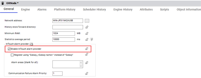

    You also need to ensure that you have at least one platform configured as Alarm Provider

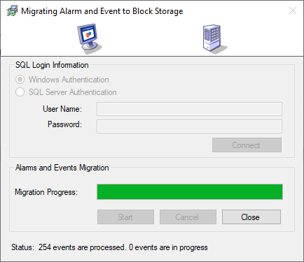

    If you have been running your system with the 'Traditional' setup and decide to make the switch to 'High speed' you need to manually migrate the data in your A2ALMDB to Historian if your intention is to merge the existing records in to Historian using the aahBlockMigrator.exe found in the folder C:\Program Files (x86)\Wonderware\Historian\x64
    Keep in mind that the migration tool will only accept the database name A2ALMDB, and will fail to connect if your alarm database is named something different, such as WWALMDB, and it will fail if the database is created in Consolidated Mode!
    With this said, switching to High Speed will still allow you to log using the legacy option using Alarm DB Logger Manager and your A2ALMDB in parallel, if desired.

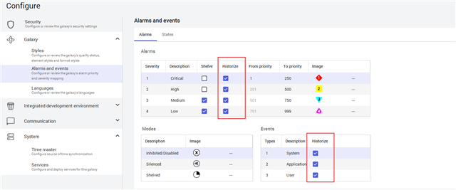

    To start the switch you can verify some configuration in your galaxy, Historization of alarms is enabled by default, but its good to know that you have options to change.

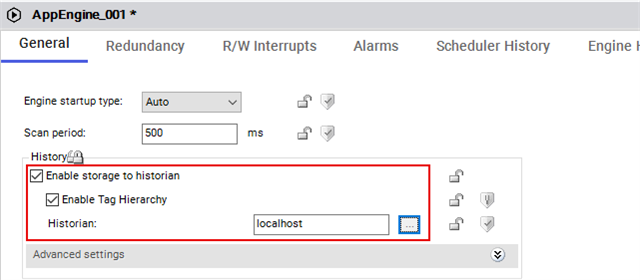

    Your engine has to be set up to Enable storage to Historian, and perhaps this is already in place if you are logging attribute data to Historian.

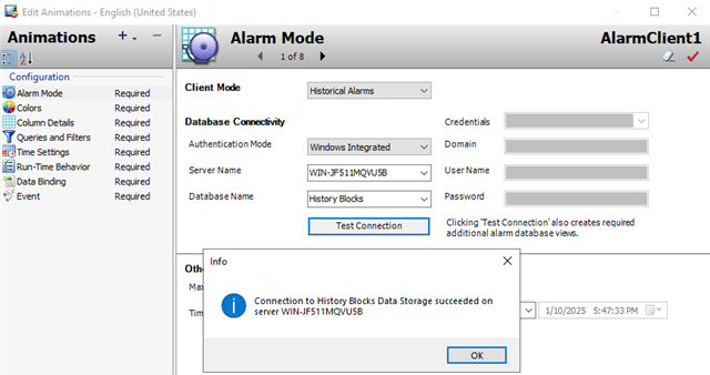

    Lastly you need to make the changes in any History alarm components, switching to History Blocks, and if you have any 3rd party reporting tools, make proper changes to connect to the Runtime database and the Tables and views available there.

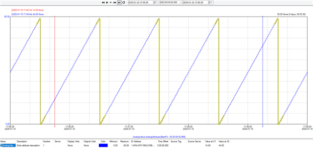

    one question out of curiousity regarding the screenshot of the trend, what am I looking at there?

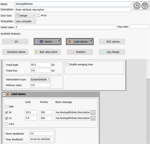

  • A good observation, one advantage of using Historian to log the alarms is that active alarms will be integrated in the client components, such as trend, in my screenshot the alarm was active as High alarm on value > 55 and Lo alarm > 5.
    This is also true for displaying trend data using Insight.

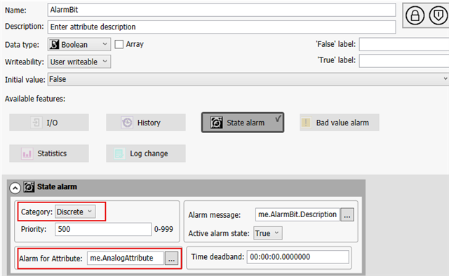

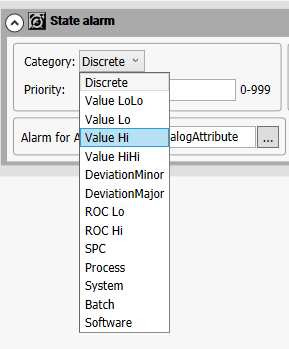

    This is also possible if the alarm attribute is linked to a historian attribute (History value and Alarm value are not the same attribute), and you can set the Category on the alarm bit to improve visibility in your clients.
