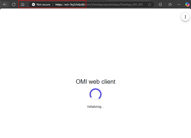

I am trying to access OMI web client on a remote node, but it is not opening it keeps loading. On the GR it opens perfectly. The node I am trying to access OMI web Client with I have installed the ASB root certificate and it's on the same network as the GR. I am using Edge and Mozilla fire fox as the browser.
What could be the issue?

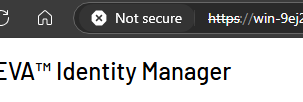

    When navigating to your server, does the web-browser show any indication of invalid certificate?
    vs.

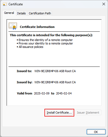

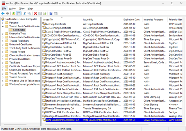

    Did you make sure to install the ASB certificate in your Trusted Root Certificate storage?
    On your client, can you locate the certificate in the Certification Storage? (manage computer certificates)

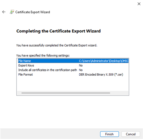

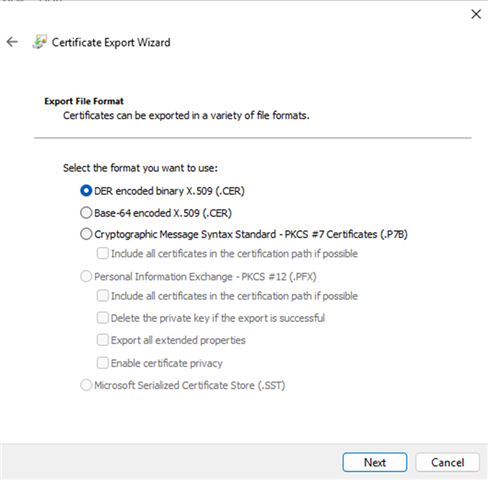

    To add to the verification, how did you export the ASB certificate?
    I made the following guide based on what I had to do to get a client, that has no AVEVA software installed, to access my deployed OMI application in a lab environment.
    On your server hosting OMI Application,

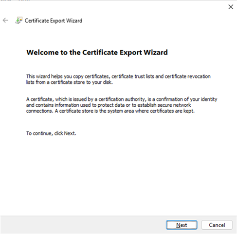

    Start the Manage computer certificates

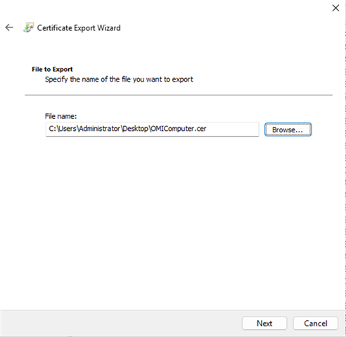

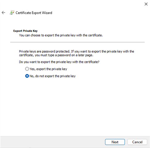

    Locate your local ASB Root CA and use Export (Right click, All Tasks - Export)
    Move and install the exported .cer file on your client machine, (I have also successfully tested on a Android device)
    You can just open the .cer file and click Install Certificate

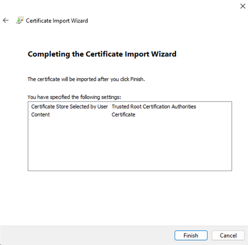

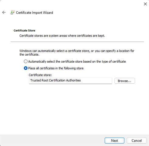

    Select Local Machine
    Its better to manually select the store as Trusted Root Certification Authorities
    Finalize the install
    Restart your web-browser, that should be it!
