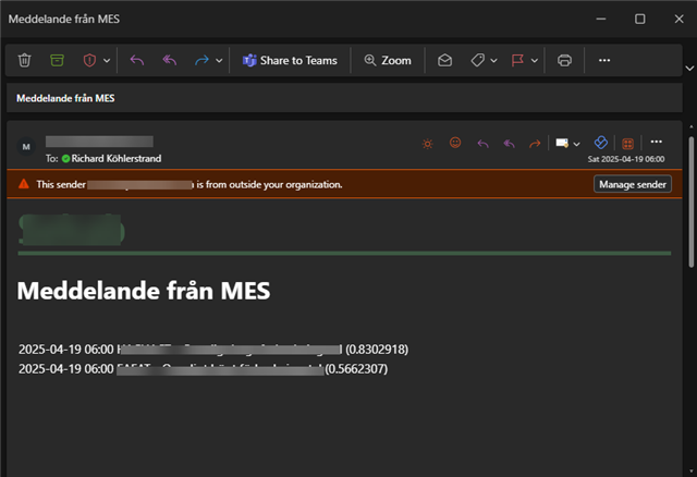

    A tip to enrich your content is to use html code in your body segment.
    This will allow you to add formatting and even images in your email.

    (example of email with html content)
