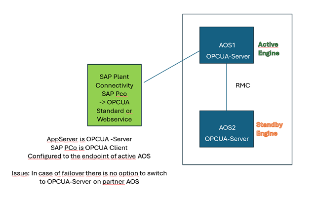

Hello everybody,
I’m searching for a solution and have no idea:
  • Redundant AOS-Pair:
  • Both AOSes are configured as OPCUA-Server
  • Communication between SAP PCo and the node with active engines
  • In case of a failover, in worst case AOS1 goes down, is there any option to switch this communication to OPCUA Server on AOS2?
Please finde attached a schema.
I know AppEngine Failover is decoupled from PCS. I have no idea how to support my customer in that case.
Maybe, I have to recommend to use another interface of SAPPCo, e.g. Webservice. So a RDI- Object could become the solution…
Thanks in advance for any idea!
