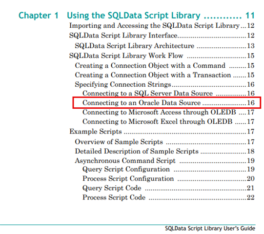

    The SQLData Script library (aaDBIntegration) is included in any newer version of a galaxy and according to the documentation, it seems to support Oracle too.

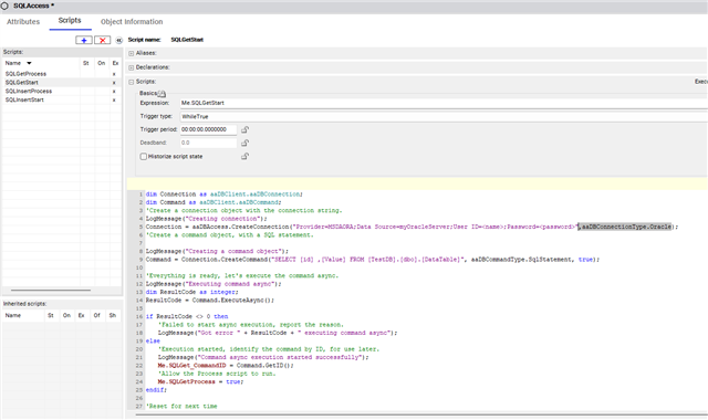

    Add one script, the example was using a SQL Server so you might need to modify your connection string and query to match your Oracle server
    I have modified the script to what i expect you to do but since i don't have an oracle database to test with you can consider it as pseudo code Slight smile
    But the documentation can help you here.
    dim Connection as aaDBClient.aaDBConnection;
    dim Command as aaDBClient.aaDBCommand;
    'Create a connection object with the connection string.
    LogMessage("Creating connection");
    Connection = aaDBAccess.CreateConnection("Provider=MSDAORA;Data Source=myOracleServer;User ID=<name>;Password=<password>",aaDBConnectionType.Oracle);
    'Create a command object, with a SQL statement.
    LogMessage("Creating a command object");
    Command = Connection.CreateCommand("SELECT Id, Value FROM Person.Contact WHERE (ID > :lastName)", aaDBCommandType.SqlStatement, true);
    'Everything is ready, let's execute the command async.
    LogMessage("Executing command async");
    dim ResultCode as integer;
    ResultCode = Command.ExecuteAsync();
    if ResultCode <> 0 then
    	'Failed to start async execution, report the reason.
    	LogMessage("Got error " + ResultCode + " executing command async");
    else
    	'Execution started, identify the command by ID, for use later.
    	LogMessage("Command async execution started successfully");
    	Me.SQLGet_CommandID = Command.GetID();
    	'Allow the Process script to run.
    	Me.SQLGetProcess = true;
    endif;
    'Reset for next time
    Me.SQLGetStart = false;

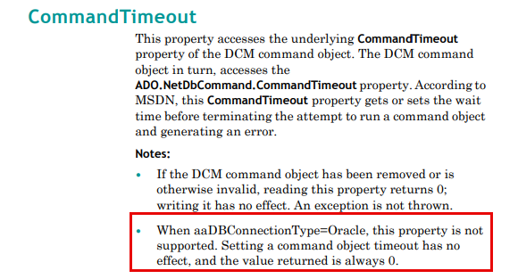

    A thing i found that could be good to know is that normally (Using MSSQL), you can set a CommandTimeout on the command object, it seems to not apply for Oracle connections
  • I gave that a whirl first up but run into this although I have the latest client installed:
    Open() in DCMConnection failed: 'System.Data.OracleClient requires Oracle client software version 8.1.7 or greater.'
    System.Data.OracleClient has also been deprecated.  It is one rabbit hole after another.
