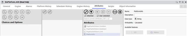

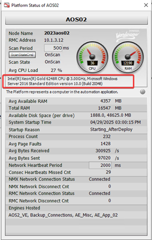

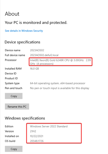

The info shown in the object shows the wrong server info (red rectangle). The current server is a 2022 server. Where is this info populated ?
The info is written in the object , but is calculated.

    My Windows Server 2025 running System Platform 2023 R2 SP1 was also displaying value for PlatformInfo as Windows Server 2016.
    But when Running System Platform 2023 R2 SP1 P01 it will be displayed correctly.
    So it seems to be fixed in Patch 01
