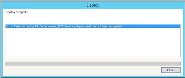

In our network setup, we have configured two runtime clients. The deployment to the first client was completed successfully. However, when attempting to deploy to runtime client 2, the process fails with the following message:
"Previous deployment has not been completed"

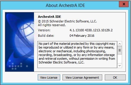

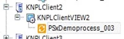

I have attached the error message, System Platform Version and status of Demoprocess icon.
Please let me know if you need any logs, screenshot or additional information.
Thank you in advance for your support.
  • Unfortunately you are stuck with the orange icon when deploying the application.
    The symbol indicates file transfer in process, and I am assuming it does not complete after a while.

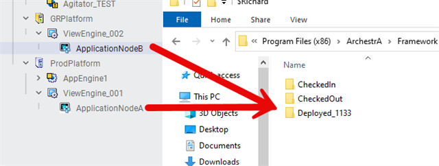

    The folders in step 3-5 in the technote are not fully described, but to understand what's going on let review what happens when you work with a managed application.
    When you create a managed application in IDE, it is initially stored the file system of your GRNode.
    In the location, C:\Program Files (x86)\ArchestrA\Framework\FileRepository\<Galaxyname>\ObjectFileStorage\<InTouchViewAppName> with folders for checked in and checked out. to be able cater ongoing development.
    These should not be touched and loss of your application could happen if you remove them.

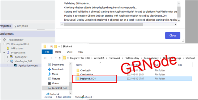

    Once you deploy your application to a remote node, there are several things happening, but from an application perspective, the GRNode creates the folder structure to support running the application on the remote node.

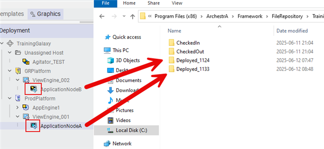

    But it also creates a copy of the deployed application locally in the above mentioned folder.
    This is what's being distributed to the remote node (remember that you can have different 'versions' of the same app on various client nodes depending on when you decide to deploy changes).
    So if you have multiple folders, it might mean that you have different versions of your application active.
    Once all are up-to date, only one folder should exist.

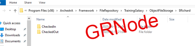

    If you manually delete the Deployed_* folder, a folder containing the (newest version) will be re-created on the next deploy.

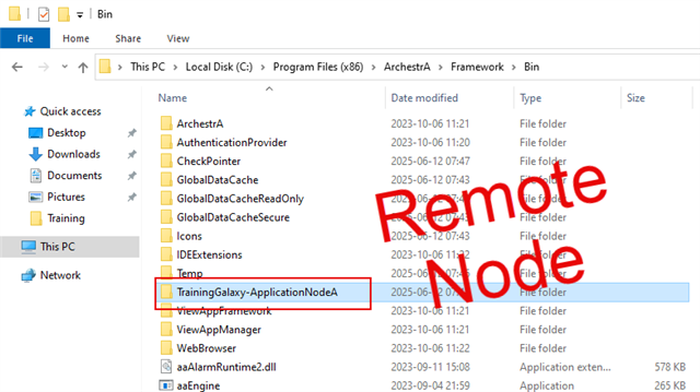

    But initially it creates copies the application to the following folder
    C:\Program Files (x86)\ArchestrA\Framework\Bin

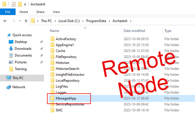

    The folder C:\ProgramData\ArchestrA\ManagedApp is not populated yet, but will be as soon as you start your application, a folder might exists if you have stared any other application earlier.

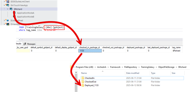

    Also, when a deploy happens, the GRNode updates the gobject table in the galaxy database, this controls the known state of the deployed object, in your case the application.
    If you get stuck at some point of your deployment, witch the GRnode is unable to recover from, you need to manually help it to get back to a normal state, fix the reasons for the failed deploy and try again.
    So to clarify the steps in the technote
    • Delete "C:\Program Files (x86)\ArchestrA\Framework\Bin\<Deployed IntouchViewAppName Folder>
      (On the remote node)
    • C:\Program Files (x86)\ArchestrA\Framework\FileRepository\<Galaxyname>\ObjectFileStorage\<InTouchViewAppName>\Deployed_<nnnn> folder
      (On The GR)
    • Clear the contents of C:\ProgramData\ArchestrA\ManagedApp (which is the default local working directory)
