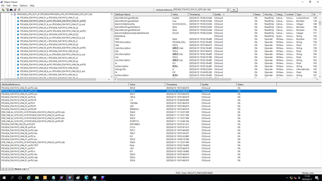

In one semicon project ,we met a very strange issue of system platform 2020 R2 sp1 . The value of  application object in AppEngine doesn't update .

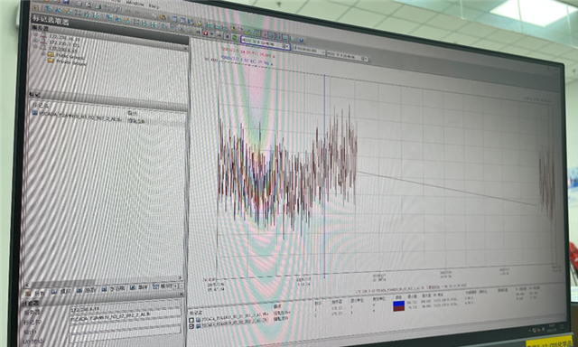

The customer didn't find this issue until they checked the trend of one application object,the data didn't change for a long time.
But everything looks good in object viewer.
