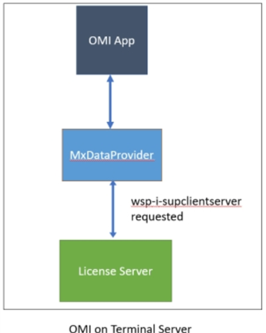

According to article # 000035206 you need to have a local License Server installed and the Supervisory Server license should then be activated on this local License Server. You should also have a MxDataProvider deployed to this server. For web clients to get 'access' to the 'unlimited' server side license it should only access data through the local MxDataProvider and that is only possible if you have a local License Server.

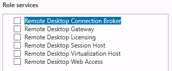

My next assumption, triggered by an entry in the logger (This machine doesn't have Remote Desktop Services enabled.) is that it might have something to do with Windows Server Roles.
Is this assumption correct and if so which role(s) is applicable for (i). web clients only (ii). web and rds clients?
