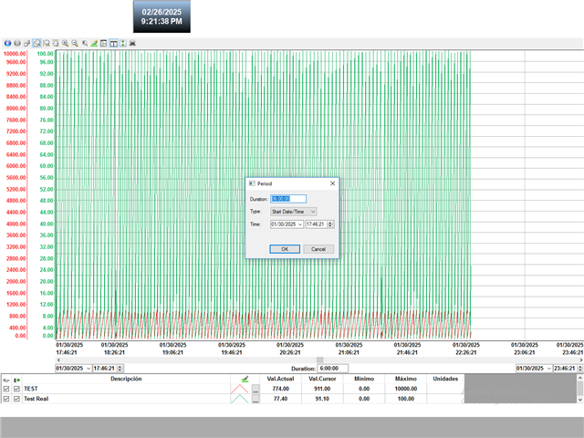

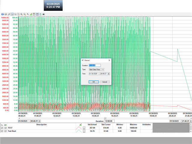

  • Hi Scott. Thanks for your replay.
    In the first figure, you can see the span for the trend is 12 hours and there is a gap between (aprox)19:06 and 21:46, but in the second figure, with a 6 hour span, it shows valid data from 17:46 thru 22;26.
    If I load again a 12 hour trend, it sometimes shows gaps in other places in the same date.
