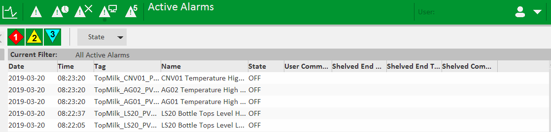

    In my example_sa project the default format is not like you describe, see my print screen below.
    If I add as you describe there is no difference in the format view of Active Alarms page.
    If I follow the additional step described by Ignatious, adding the Format name to the AlarmPage_Init function, then it works.
    What do we conclude from this, is there a mismatch somewhere?
    My version is 8.10 Update [Dec 11, 2018)[0]
    Rune

  • Rune,
    The format of your active alarm page looks like it is using the shelved alarm page's format.
    Something might be off there, if I follow Bradley's steps it changes the columns on display in the active alarm page.
    You could dump the kernel for the client process and check in the kernel.dat the actually loaded [Format]Alarm parameter values (last section of kernel.dat dump.
  • Erik,
    This from the kernel.dat file:
    [FORMAT] ALARM= {Date,100}{Time,74}{Tag,136}{Name,177}{State,73}{Comment,97}{Disableenddate,111}{Disableendtime,112}{Disablecomment,113}
    [FORMAT] INFOALARM_HD1080= {PriorityandState,24}{OnTime,90}{Item,100}{Name,240}
    Setup->Paramteres is set with:
    Section Name = FORMAT
    Name = Alarm
    Value = {PriorityAndState,25}{OnDate,80}{OnTime,90}{Name,250}{State,40}{Cluster,70}{Equipment,220}{Item,160}{UserName,100}{Comment,250}{Category,60}
    Rune
  • Rune,
    This seems to suggest you have configured another format in the ini 9and the display is correct based on the parameter value loaded in runtime).
    Can you check what is in the citect.ini you use or in the profile?
    The precedence is that ini wins over anything configured in the params.dbf in project (see the help Parameters > About Parameters > Parameter Precedence).
  • correct Erik,
    the ini had a Format section which seems to be set to the default. remove it and it uses the value in the parameter.dbf.
    Thanks.
