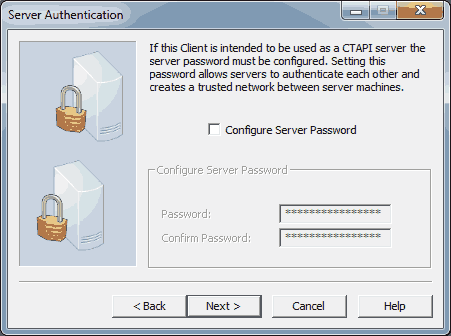

We're attempting to set up a new client computer at a site using Vijeo Citect 7.50. The server is displaying values in the HMI, and when we set up the new machine as a server, it will also display values.
However, when we set it up as a client and initially go to runtime, the values display, then go to #BAD/#COM, then display, then back to #BAD/#COM. We have the firewalls disabled, the computer role is set up properly in the citect.ini file. We are pointed to the correct project paths within the .ini file. Under Servers -> Network Addresses we set the address to the IP of the Server/development machine. We can successfully ping the PLCs and the server.
Any ideas about what else might be causing the issue for us?
