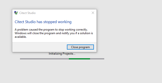

I have Citect SCADA 2018 version 8.10 installed on my laptop running Windows 10 Enterprise version 1709.  I was using the graphics editor trying to change a screen template on a converted 7.20 SP3 project when the Studio crashed.  Now when I start Citect Studio I get this message.  Any help getting Studio running again would be greatly appreciated.  Thanks

  • When you say "converted", was the graphics files upgraded? Or just the project itself?
    Citect Studio reads up the projects listed in Master.dbf to determine what to display and process. You could either move the offending project folder somewhere else (to make the master.dbf entry for that project invalid) and then startup Studio. Studio will complain about a missing project, but you can always add it back OR restore the old project(s) again and attempt the upgrade process again.
