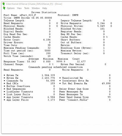

I checked the kernel (Driver) - DNPR driver and on particular port I found App Layer Fails (Count: 3173).
I want to know more about this "App Layer Fails"
I also want to know about ToQueue Length and Legacy ToQueue Length that is showing on Driver statistics page of Kernal.
Please share some knowledge. or white paper.
