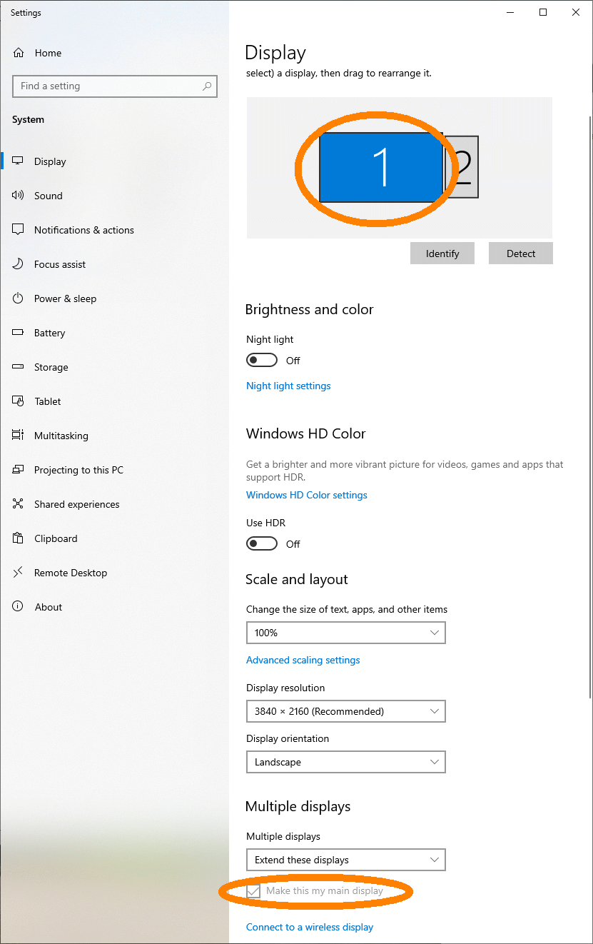

  • Try setting your left monitor as the main display in the Windows Display properties. I believe if your right monitor is the main display then the left monitor's x coordinates will be negative and components that are not multi-monitor aware may change the negative coordinate to 0, causing it to display on the edge of the other monitor.
  • Hello Eric,
    even if the left monitor is the main screen, the popup of the combobox still appears on the left screen, no matter on which screen the ActiveX object is located.
    Any other ideas?
    Dank you.
