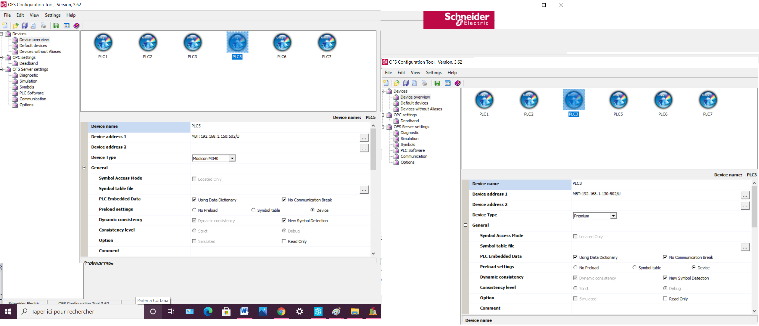

  • Three Schneider electric PLCs, type PREMIUM (REF: TSX P57) redundant and three others, type M340 (REF: BMX P34 2010),
    Please find attached my configuration
