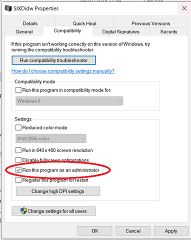

  • Finally i got the resolution, though i have used administrator login while installing the back-end driver, i have to change the Comptability properties of SIXDidw.exe at path C:\Program Files (x86)\AVEVA\Citect SCADA 2018 R2\Bin and check the option Run this program as administrator. Rest all settings are according to configuration manual....
    Thank you for all for your kind support.
