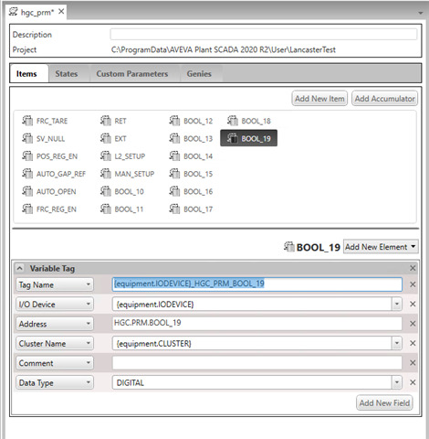

Hey Guys,
Real quick, is there a way to reference the item name in the equipment editor?
Trying to build a bunch of equipment and data types. Being able to reference the equipment name would save me some time.
Currently my tag name looks like this: {equipment.IODEVICE}_HGC_PRM_BOOL_19
Where I wish i could put {equipment.IODEVICE}_HGC_{equipment.ItemName}
Thoughts?
Thanks guys!
-Nick

    Bool_19, yes, is my item name. I'm trying to avoid having to re-type/paste it into the Tagname and Address field.
    So i'd like to find a syntax to be {equipment.IODEVICE_HGC_PRM_{equipment.itemName} for the tagname
    And {equipment.IODEVICE}HGC.PRM.{equipment.ItemName} for the PLC address.
    The idea is, if I make 1 item, then simply, duplicate the item and rename it to the item name i want, which matches with the PLC address, I can cut down alot of time adding items/tags.
    This is a control logix PLC with ALOT of UDT's.

    Item Name doesn't exist in the equipment dbf file so you cannot reference it in the template. In your screenshot, you are actually editing item Bool_19 that is a known value. So you have to duplicate it in both Address and Tag Name fields. Bool_19 will be added as an item name in Variable.dbf when the template is instantiated.
