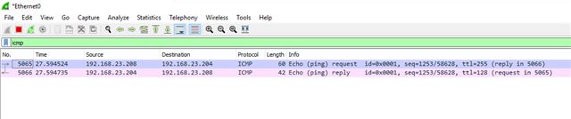

It seems the driver will only send the PING request once on startup.
Screenshot Below taken from wireshark running on VM 192.168.23.204.
Citect Server is 192.168.23.208.

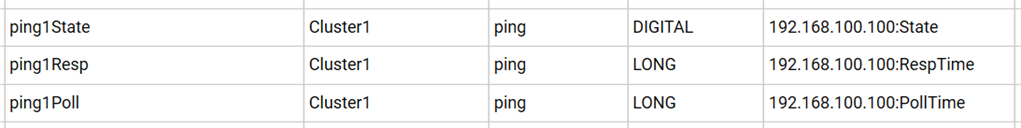

  • Make sure the state tag is configured as DIGITAL and resptime as LONG (this was not visible in your screenshots). I don't think it is needed to fill the scaling fields, but if you do, make sure to fill RAW_ZERO and RAW_FULL as well.

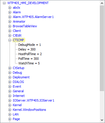

    According to the CTICMP.chm help file, citect.ini parameter [CTICMP]HostPollTime is responsible for the ping interval (in seconds) to all hosts. Default value is 30 seconds. For your individual host you can define a LONG variable tag with address "192.168.23.204:POLLTIME" and set it to the value you need.

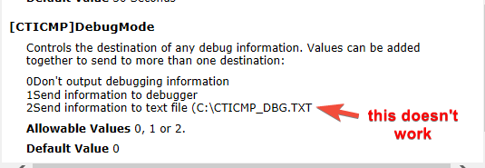

    For logging I believe there is a documenation error. I don't think [CTICMP]DebugMode is a valid parameter anymore, but that the driver now confirms to the new universal driver logging mechanism:
    Please try setting parameters [CTICMP]DebugLevel=ALL and [CTICMP]DebugCategory=ALL. Results should appear in the I/O server syslog.dat file in the default Citect log folder.
    Allowable parameter values for DebugLevel are: WARN, ERROR, TRACE, DEBUG and ALL.
    Allowable parameter values for DebugCategory are: PROT, DCB, MISC and ALL.
    Values can be combined using the pipe (|) symbol. For example: [CTICMP]DebugLevel=ERROR|WARN|TRACE

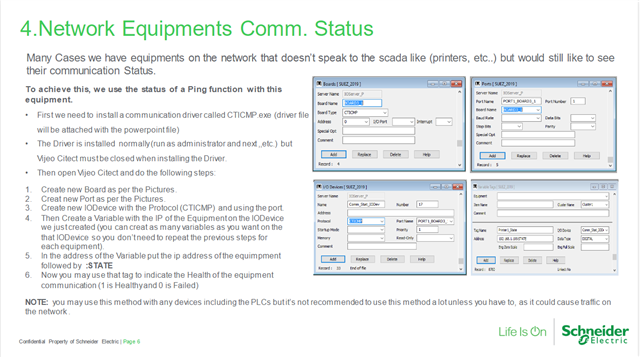

  • Hello
    i have achieved this functionality in a site before using CTICMP driver and it's working perfectly, let me attach slide that explains how to use it

    I updated the drive from 3.2.0 >> 4.0.2.
    In the updated documentation it states that the HostPollTime is in (units) milliseconds.
    I updated my parameters to suit:
    [CTICMP]
    DebugLevel=ALL
    DebugCategory=ALL
    HostPollTime = 2000
    HostTimeout = 3000
    And now it is working as expected!
