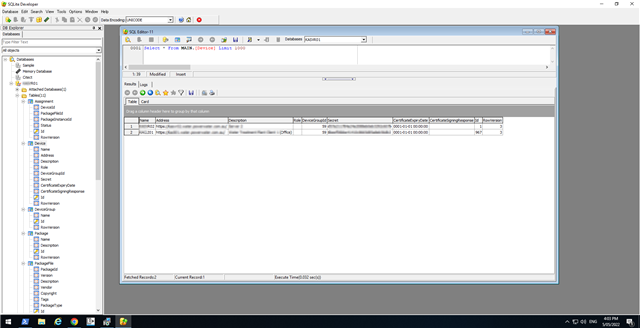

It seems that you can open the database and modify it there:
C:\ProgramData\AVEVA\Citect SCADA 2018 R2\Deployment\Server\Database\deploymentstore.sqlite
Has anyone successfully pulled this off? Or know of a less hacky way to get the Deployment client to appear back in Citect studio ?
