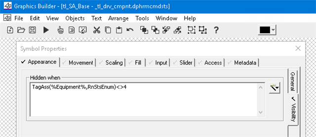

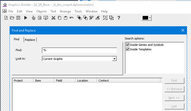

I have some genies that when I do a Find "%" in them, it comes up blank. Yet there are dynamic properties with substitutions in there.
Anyone seen this sort of thing before? Tried packing and updating etc but no change. Running 2020R2

Also tried the GBA open/save/close every single genie/symbol/template method - but no change.

Also have another Find issue whereby the Find "%" on a few genies returns "phantom" expressions containing non-existent substitutions (not there using either GBA or drilling into objects manually in Graphics Builder.
I guess I am trying to work out if I should pursue this issue - or is this just what we should expect from Citect / PlantSCADA? There seems to be no validation / cleaning tool or procedure that can resolve them and it is taking literally days of time trying to get a handle on them all.
