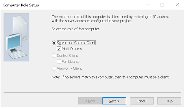

  • Make sure the runtime is looking for the correct type of license. The key update utility should say you have 1 full license (a server license). Run the Computer Setup Wizard and choose "Server and Control Client". Then it will look for a full license in the runtime.
    If your license is for a Control Client or a View-only client, select the correct option in this page of the wizard.
