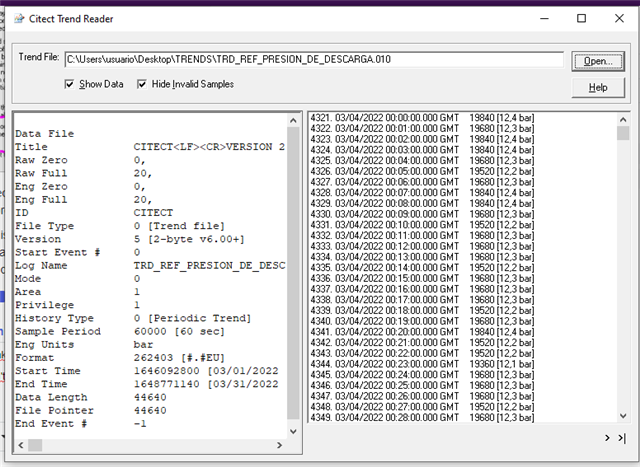

My final goal is to export the trend data to a csv file, it's not mandatory cicode. I've already tried "Citect Trend reader" but there is no "Export" button. You can only view the data.
