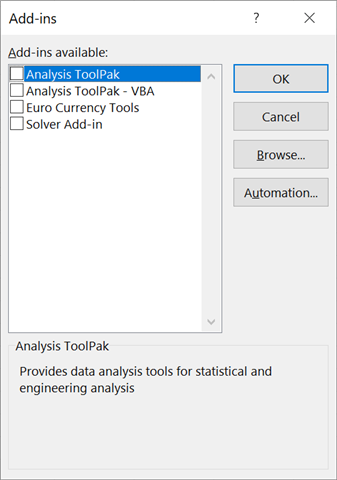

  • I believe this tool is installed separately. You cannot reinstall it if it still remains on Programs & Features list.
    This tool could be deselected in Excel options during installation of PI related Addins. Go Excel's File/Options and check if the tool is still there. If yes, simple tick the checkbox. You could also use "Browse" button to add the tool from its installed location (\ProjectDBFAddIn) if it was removed from the addins list.
