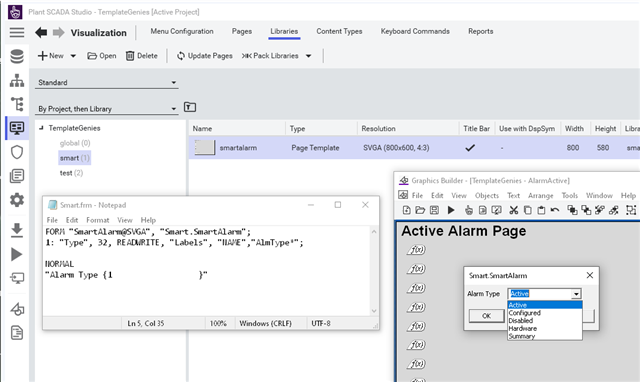

  • Yes, you can create a FRM file for a template. That should allow you to arrange the substitutions so the form fits on screen.
    You can find examples of this functionality in the Include project for the legacy templates, like standard.ctt and standard.frm.
    Here's a simple example I had created in the past. Note that you need to specify the resolution as part of the genie name, like "SmartAlarm@SVGA":

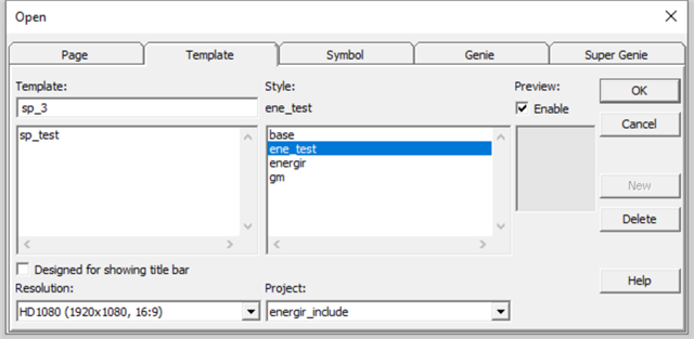

    I created a test template in a new style. The template contain 2 parameters, %Tag1% and %Tag2%.

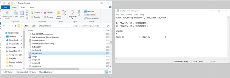

    Then I've made the FRM file like this:

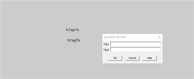

    Then I created a page base on this template but the form those not reflect the text file:
    Any idea ?
  • I don't see the problem with what you're doing. You even got the -HD1080--I forgot to mention that for templates with the Show Titlebar option disabled.
    I have attached my (PlantSCADA 2023) test project. I created a template called smartHD, saved as HD1080 resolution with no titlebar. I created a page called SmartHDNoTitlebar based on that template. My .frm file is set up like yours with similar spacing and line breaks. However, mine works.

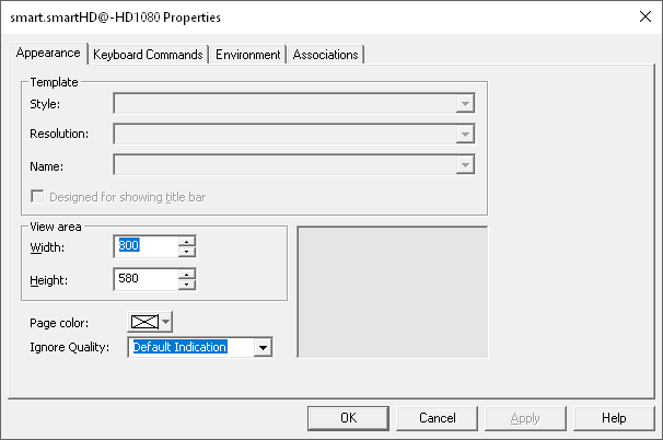

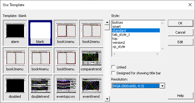

    I did notice that if I created a template based on (linked to) another template, then the popup form didn't appear. When you create your template, make sure you uncheck the Linked option so your template has an unlinked copy of the objects from the base template you choose. You can base your template on the blank template like this:
    Then if you look at the properties for your template, it should look like this, with no base template:
