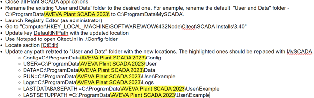

  • Yes, it is possible on the same drive. I assume that you are using Plant SCADA 2023.
    • Close all Plant SCADA applications
    • Rename the existing 'User and Data' folder to the desired one. For example, rename the default  "User and Data" folder - C:\ProgramData\AVEVA Plant SCADA 2023\ to C:\ProgramData\MySCADA\
    • Launch Registry Editor (as administrator)
    • Go to "Computer\HKEY_LOCAL_MACHINE\SOFTWARE\WOW6432Node\Citect\SCADA Installs\8.40"
    • Update key DefaultINIPath with the updated location
    • Use Notepad to open Citect.ini in .\Config folder
    • Locate section [CtEdit]
    • Update any path related to "User and Data" folder with the new locations. The highlighted ones should be replaced with MySCADA.
      • Config=C:\ProgramData\AVEVA Plant SCADA 2023\Config
      • USER=C:\ProgramData\AVEVA Plant SCADA 2023\User
      • DATA=C:\ProgramData\AVEVA Plant SCADA 2023\Data
      • RUN=C:\ProgramData\AVEVA Plant SCADA 2023\User\Example
      • Logs=C:\ProgramData\AVEVA Plant SCADA 2023\Logs
      • LASTDATABASEPATH =C:\ProgramData\AVEVA Plant SCADA 2023\User\Example
      • LASTSETUPPATH =C:\ProgramData\AVEVA Plant SCADA 2023\User\Example
