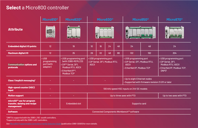

We have a partner SI looking to connect to some RO Skids with Rockwell Micro850 PLC's and PanelView 800.
Is there a driver that can be used with Plant SCADA to communicate to the Micro850?
I read in another article from Indusoft they used Modbus TCP -MOTCP. Not sure if this would work here as ModNet or other?
Can you please advise.
Thanks.
  • Hi  ,
    It looks like there are quite a few options to communicate with this device:
    - CIP Serial
    - DF1
    - Modbus RTU/ASCII
    - EtherNetI/P
    - Modbus TCP
    There are a number of drivers available in Plant SCADA, namely:
    - ABDF1FD (DF1)
    - MODBUS (Modbus RT/ASCII)
    - ABMLXEIP (EtherNet/IP)
    - MODNET (Modbus TCP)
    I think Modbus TCP / MODNET would be the easiest to get going.
    They could also consider the ABMLXEIP driver, but this was tested against the following hardware, so might need some care when configuring:
    MicroLogix 1000, 1100, 1200, and 1500 devices.
    Hope this information helps.
