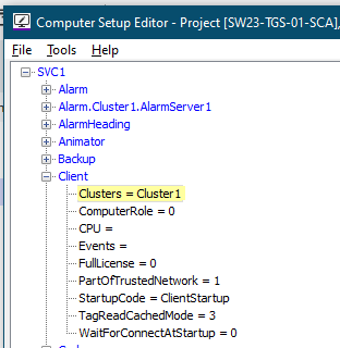

    Take a look at [Client] section of the profile where it should have the following parameters
    • Clusters = [your clusters separated by comma]
    • ComputerRole = 1 (for control client and 2 for view only client)
    • PartOfTrustedNetwork = 1
    Hope the info here is helpful.

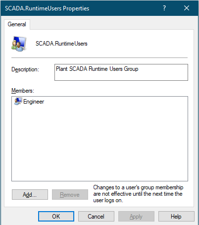

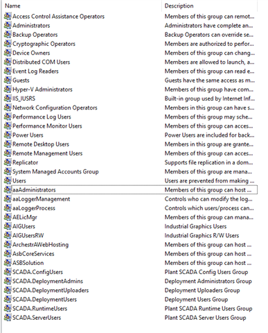

    - I am using plant SCADA Authentication, Plant SCADA Authentication is  my issue (should be signed in in runtime with any user ,[not necessarily  admin user], to be able to write values to Modbus).
    - The profile is created using the topology yes.
    - yes I have used the configurator and configured my settings.
    - yes I am using the machine as a deployment server.
    - the client parameters are all configured as you described, but we are still facing the issue.
    I will attach photos for settings that are related to my issue, I wish this will help you troubleshoot.
