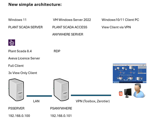

I have Plant Scada 8.4 Server Windows 11 with license manager (1-full and 3-view only clients) and second virtual server Windows Svr 2022 with installed Access Anywhere
Is it possible to download licenses from a full server for Access Anywhere installed on another PC ? OR Access Anywhere work only installed on the same machine ?
Should I then change the config.js file ?
Is this configuration possible ?

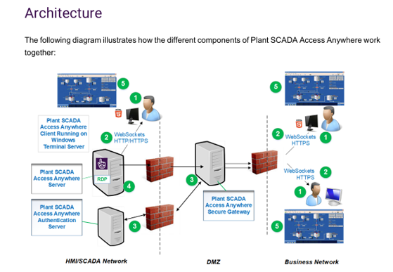

From Documentation:

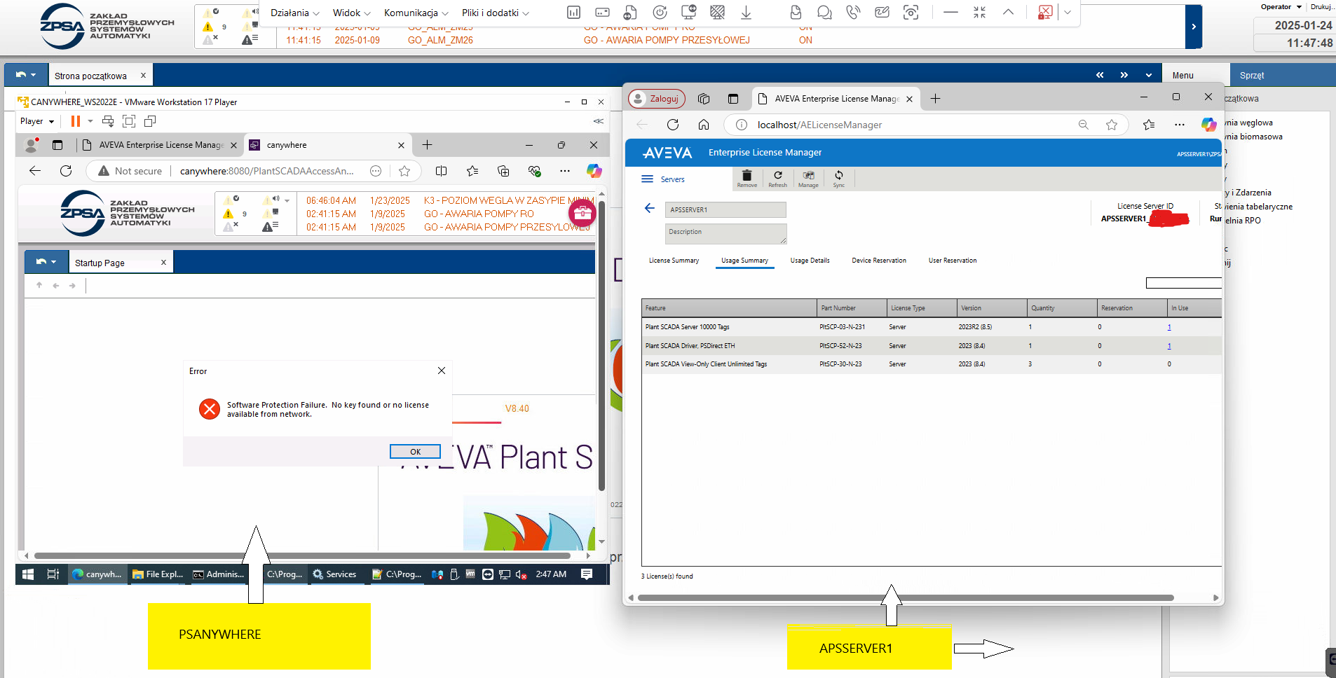

  • We have performed some tests, but Citect Anywhere can in no way download it with such a license configuration form server in this configuration.
    We also have tried to transfer license View Client to the VM machine PSANYWHERE and also receives software Protection Error

    In Configurator Server i have configured Licence Server correctly , because I am able to connect in the local network to another PC with installed Plant Scada Runtime as one of client (Configurator Client connect to Licence Server) and i see in AEL (in use licence view).
    My question how should i configure this to download the license through Access Anywhere to any computer in network (lan ,vpn) when i have licence server on on my PSSERVER (Win 11) and RDP PSANYWHERE (Win Server 2022) ?
    In normal configuration I have always had a license server and RDP on the same machine.
