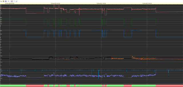

I have a trend in process analyst looking like this:

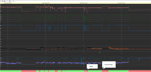

Every occurrence that the line stops, indicated in GREEN->RED status bar at the bottom of the trend, the operator should enter a reason why he stopped like BREAK or Product change.
This reason should be linked to the specific timestamp of the occurrence.
Is there a way to achieve this:
If not, is there another creative way to accomplish this?
