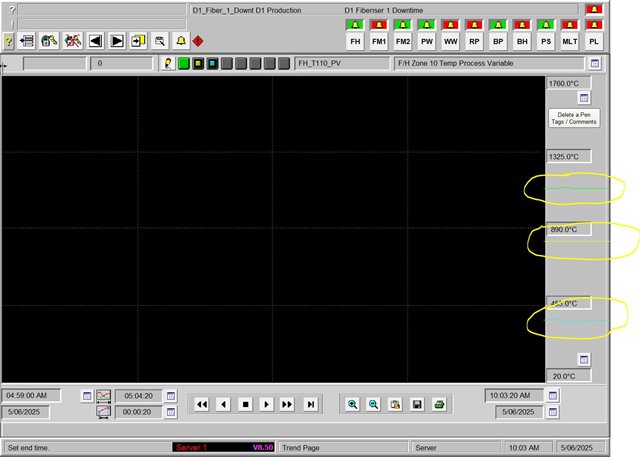

I have an issue which has oddly just appeared last few days on the primary server.
It does not seem to be project based as all other machines (Secondary server, multiple clients) are unaffected.
Any trend that is displayed, the pens are off the area where they should be displayed (see below) ?
I have tried the following
  • Restoring project, pack with included projects, compile
  • rebooting machine did not correct
  • uninstalled the Plant SCADA 2023R2 and then reinstalled, did not correct it?
What to try next?

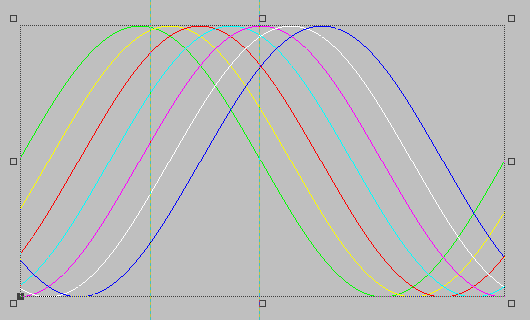

  • It looks like the legacy trend object got moved either during the upgrade or by accident when someone edited the page. There's an object like this in front of the black background:
    You'll need to edit the page and make sure the size and position match up with the black background. If the page is based on a custom template, you may have to edit the template to move the object, then resave the page to apply the change.
  • i can confirm the following from Support has rectified this issue.
    I have found a similar case for this weird behavior which presented as the same. In that case the solution from AVEVA was the following:
    The reason for the customer's issue is that they don't have 'Fast Runtime Display' option ticked in Graphic Builder.
    I can see this from their Citect.ini setting:
    [Animator]
    FastDisplay = 0
    Any particular reasons they un-ticked this option  (I believe it's enabled by default)?
    Anyway, here is what they can do in order to fix the issue:
    1. Set the project as 'active' in Citect Studio, then go to Graphic Builder -> Tools -> Options and tick "Fast Runtime Display" option.
    2. Once you OK the dialog you will get a pop-up message:
    3. Click 'Yes' and wait till the pages are updated.
    4. Full compile  ('Incremental Compile' option is un-ticked)
    5. Run the project.  The issue should be gone.
    The cause is (kind of in a round about way) explained in this KB article.
    https://softwaresupportsp.aveva.com/en-US/knowledge/details/000026153?lang=en_us
    It could also be worthwhile to check and test with “Full Screen=1” and “MaintainAspectRatio =1” if that is at all possible to see if it has any bearing on this strange behavior?
    Please have a look to this and hopefully this solves your issue as well.

  • I have seen a similar issue as well after upgrading an application from v2015 SP1 to v2020 R2.
    I had to remove the trend object from the page and re-insert it.
    It was not a CTF / Fast Runtime Display issue in my case.
    If you have the resources available, I would suggest re-engineering your trend page using the Process Analyst control. It is much more versatile than the classic trend viewer object.
