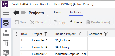

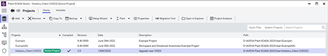

    This is what I can see:
    First project has these included

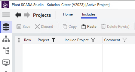

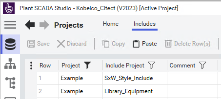

    Second project has these
    Third project (our running project has these included
