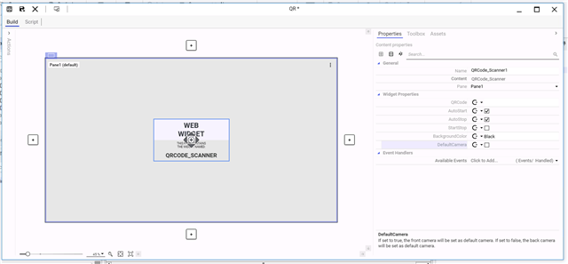

    Another thing to explore is the usage if the tablets camera to scan barcodes, but that would require some more thought to integrate with your client application.
